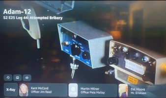

Reliving my childhood on Netflix…been watching Route 66 (1960-64): cool Vette (1960-63 models), cool cats and cool music (still love the iconic theme by Nelson Riddle). Watching Martin Miller as Todd Styles naturally led me to revisit my boyhood fav, Adam 12. It wasn’t until season 2 the radio and siren were shown on screen (1970, I was a sophomore in high school and on the volunteer fire department). (Of course, all siren sounds were dubbed in at post-production.)
Clearly a FedSig PA-20 Interceptor with Hi-Lo, and a frequent topic in this forum of Vintage and Collectible. Cool!! But I seem to recall a thread where CHP required FS to eliminate Hi-Lo for their vehicles. Did I misremember? What about LA? Was it because they could tie the Motorola radio and mic into the PA/Radio functions of the siren? Cali codes are specific and different. What’s the lowdown? Inquiring minds want to know!

HI-LO was/is not a tone authorized by the Cal Veh Code. Agencies would special order their sirens without that function or disable them in sirens that had it, either electronically or by locking out that selector position. The 'common mic' setup was unrelated and not Cal-specific, many agencies configured it to simply to eliminate a 2nd mic and dangling cord.

Our Agency in CA ran a few of these PA20's The selector knob was locked so it couldn't be turned to Hi-lo. But It is now coming into CA as a evacuation tone, many agencies both police & fire have the tone on a separate button. This started several years ago after the many huge wildfires. BUT, none of the agencies or the state has put out notices of this siren tone to the general public.

The PA20A has the hi-lo tone. The PA20 has the alert tone. I have both, and they have completely different circuit boards.
The siren sound that was dubbed in for the Adam 12 patrol car was a recording of a PA20 running in manual mode, and in drive by scenes the wail tone could be heard.

LA County/City got around the high low restriction by mounting what essentially was a form of Martin horns on their squads (county) and sometimes their ambulances (city). This is essentially two air horns that alternate blasts at different tones. I believe the way they justified it was another siren was already running so this was technically considered an air horn, not a siren. I always thought it was pretty clever that the high low air horns were sneaking by on the exception that they were, in fact, a horn not a siren. I was told that there was a local company in California making these high low air horns, I cannot remember exactly who it was. Regardless, most modern siren systems come with an option to only use California compliant tones or to disable non-compliant tones.
