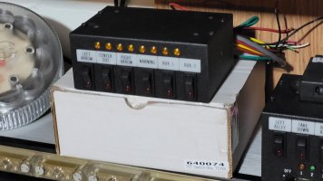

They did make a switch box but they do not require anything special. Just 4 switches to create the different patterns. Not for sale, just reference.20230409_172847.jpg
1,281
Minnesota
Thanks! You don't have a schematic by chance, do you? Curious what the PN is on the box itself?
It is just basic switches, not any type of controller. The model number is on the box it is sitting on.
Not sure if you want something authentic or hoping to find a simple way to hook up your light. It just needs 4 switches to run it's patterns. Turning on different combinations of switches activates different patterns.
